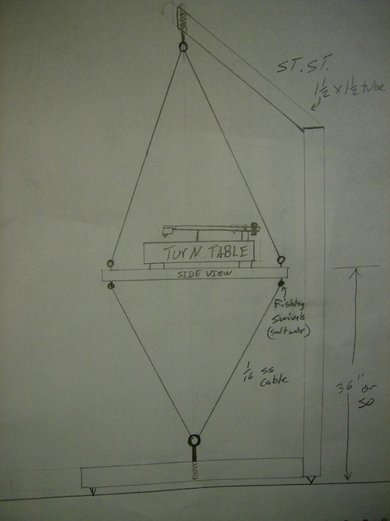

Post by mbskeam » Mon Nov 05, 2012 11:30 pm
in the design stage now, looking into rubber ISO mounts at the cable connect points.
Re: will this work?
Post by TNRabbit » Tue Nov 06, 2012 12:19 am
WAAAAAY too subject to vibration. It will be like a guitar string.
You need the heaviest base you can find. Perfection would be a 1/2 ton chunk of granite to sit it on. it needs to have an unmovable base to stop vibrations.

Post by BrianT » Tue Nov 06, 2012 6:07 am
Mike.
As Gary has already said, way to subject to vibration.
This Target Turntable Wall mount will work great
http://www.canuckaudiomart.com/details/ ... unt_black/

Post by radioeng2 » Tue Nov 06, 2012 7:50 am
Mike,
One of the most effective DIY mounting methods goes like this....
You run lag bolts into the studs of a load bearing wall to support strong L brackets. On that you attach a wooden box, about 3-4 inches deep and a little bigger than the TT, filled with sand. On the sand you place a platform which doesn't quite touch the edges of the box, only "floats" on the sand. Then set your TT on that.
Very effective!

Post by helicopterpilotdoug » Wed Nov 07, 2012 12:19 am
radioeng2 wrote:Mike,
Very effective!
Mark, I've never done this, but have seen this somewhere before. I thought at the time I read about this method it sounded like a great way to isolate your TT. Some day, I'll get around to making one and see how well it does.

Post by Chauss » Wed Nov 07, 2012 6:34 pm
Here is a DIY for a table top model:
http://www.tnt-audio.com/clinica/sandblaster_e.html
