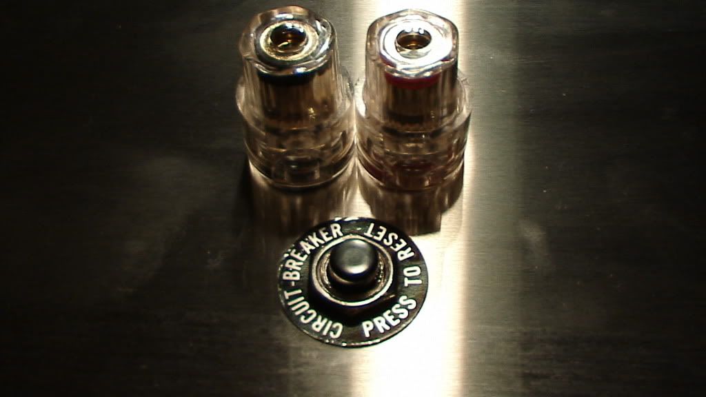

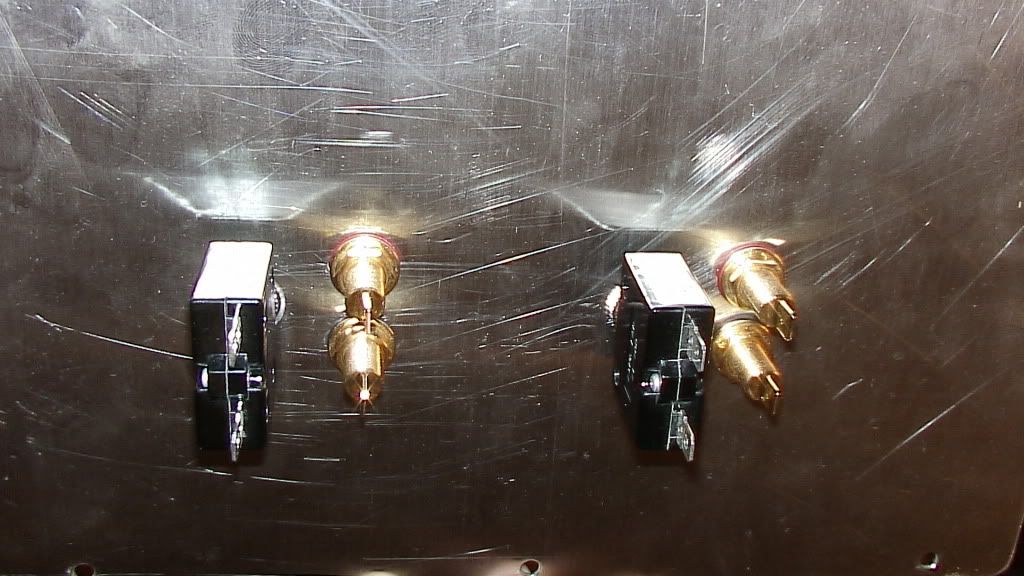

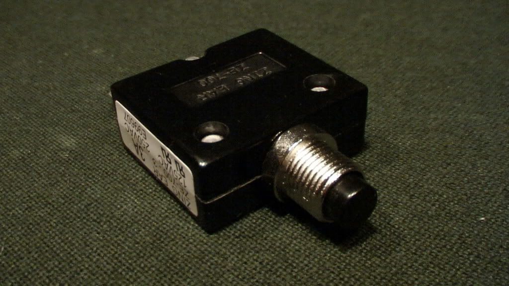

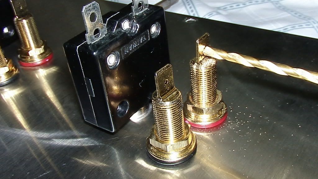

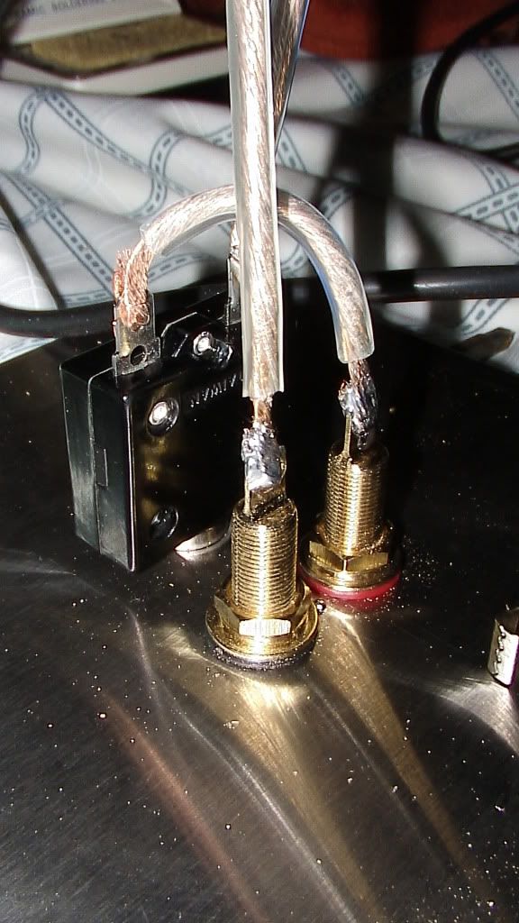

Got my circuit breakers:

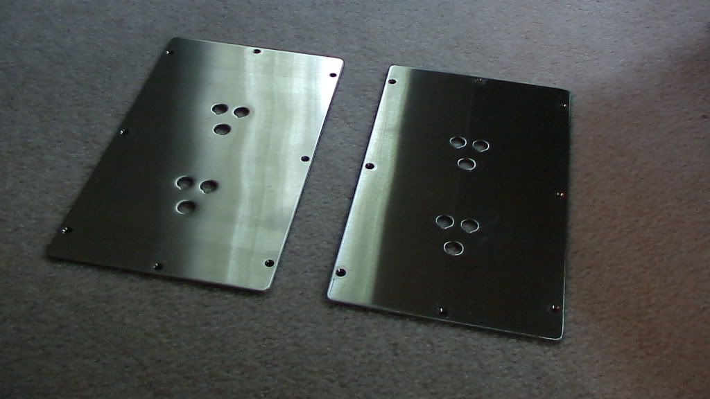

Post by TNRabbit » Wed Jul 14, 2010 4:20 pm

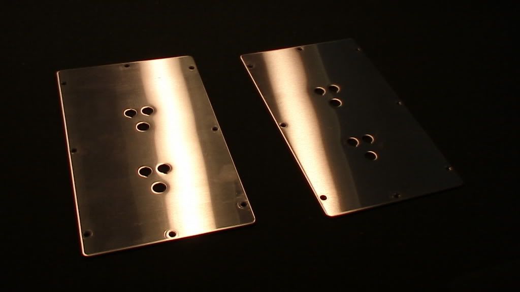

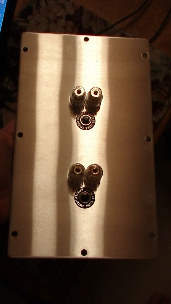

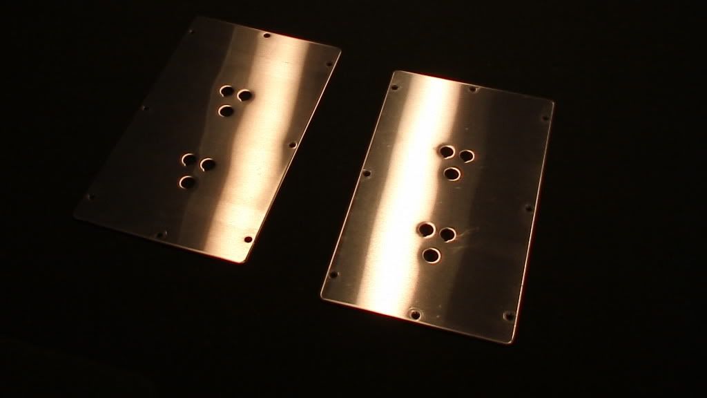

Got the stainless panels in the mail today; THANKS AGAIN, MIKE!! =D> =D> :D :D :D
BEAUTIFUL~
The right one sustained a small scratch during shipping; nothing a little steel wool won't take out~
Now to get everything together! :D :-"

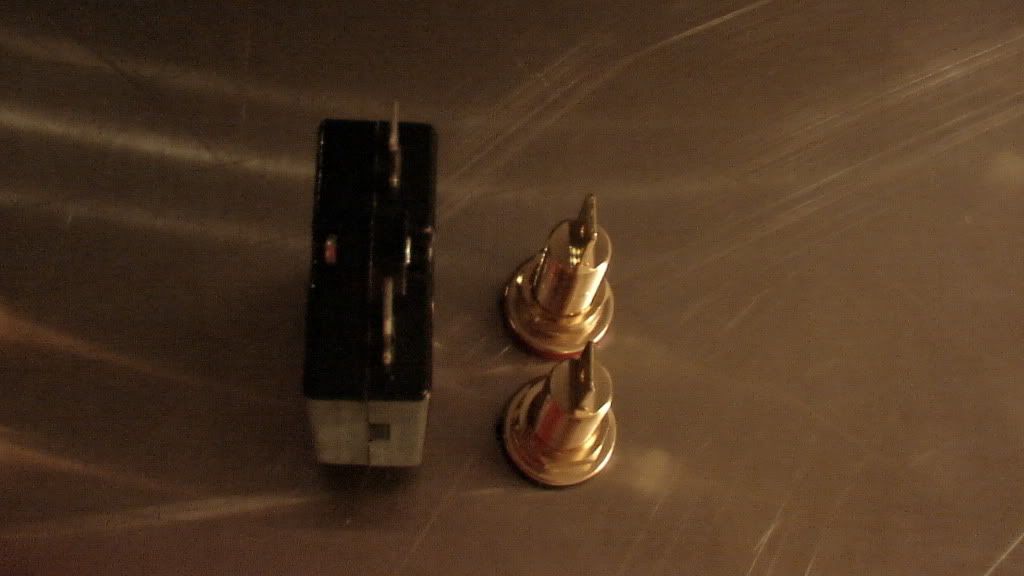

so the big ?????
do the binding posts fit???? [-o< [-o< [-o<
Re: *~Gone Active~*
Post by TNRabbit » Wed Jul 14, 2010 9:05 pm
OconeeOrange wrote:We all want to turn away, but we are captivated by the lives of the idle rich !!! ](*,)
If you knew me, you'd know I'm neither idle nor rich~
mbskeam wrote:so the big ?????

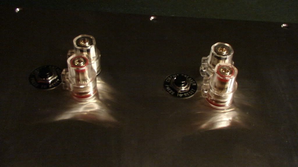

Loose fit for the circuit breakers, VERY tight fit for the binding posts, but they fit!
I didn't have the circuit breakers when you were cutting the holes; had to go by the spec.
I'll post pics later with everything installed on the panel

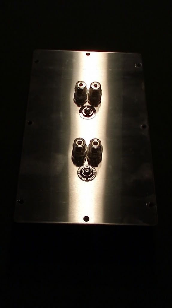

Re: *~Gone Active~*
Post by TNRabbit » Fri Jul 16, 2010 3:37 am
Posts: 5372
Re: *~Gone Active~*
Post by engtaz » Fri Jul 16, 2010 4:03 am
Are we done yet. :lol: :lol: Looks good Gary.
Posts: 2200
Re: *~Gone Active~*
Post by helicopterpilotdoug » Fri Jul 16, 2010 5:57 am
Looks great Gary! =D> Now all you need to do is put mirrors behind the speakers so they can be admired from the front. :D
Re: *~Gone Active~*
Post by TNRabbit » Fri Jul 16, 2010 5:59 am
Thanks, Roy~
Not done yet, not there yet. LOTS of soldering to do still. I think I might install push-on connectors* until I get everything where I want it, then just solder them in place.
*Image

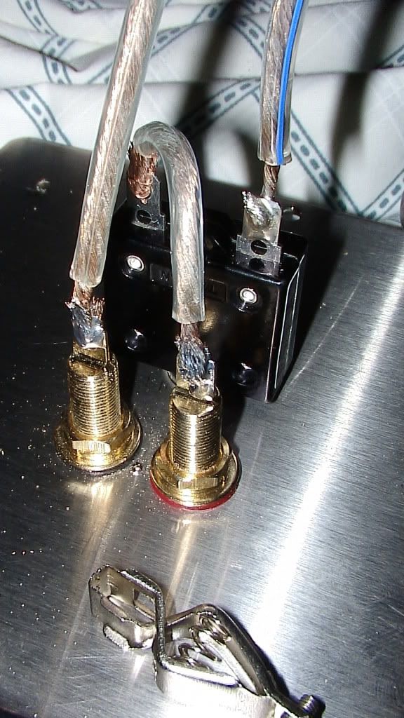

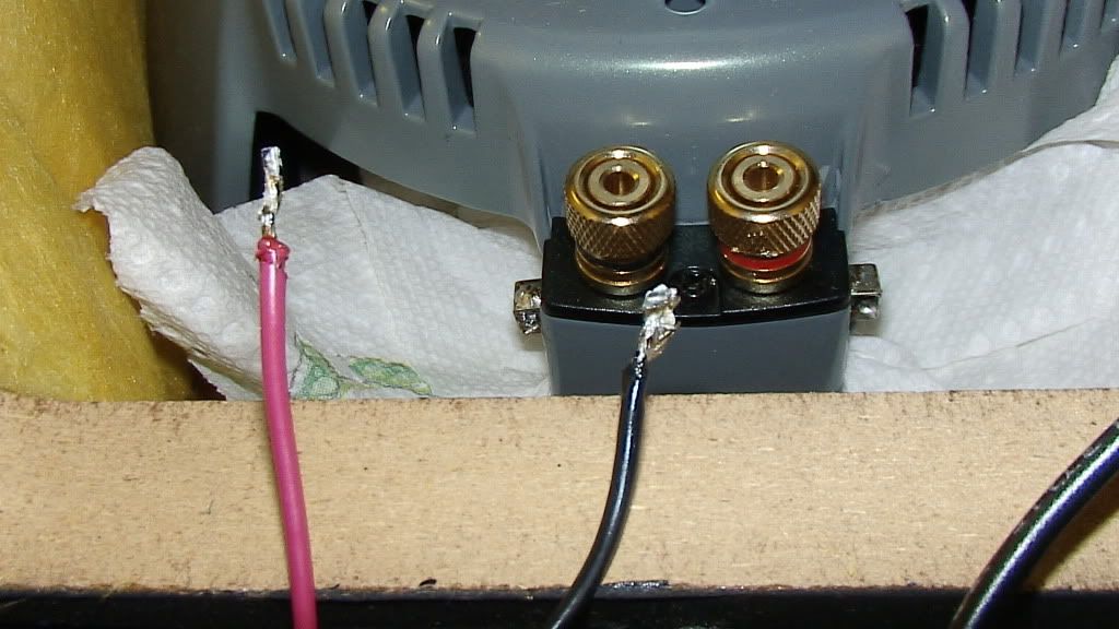

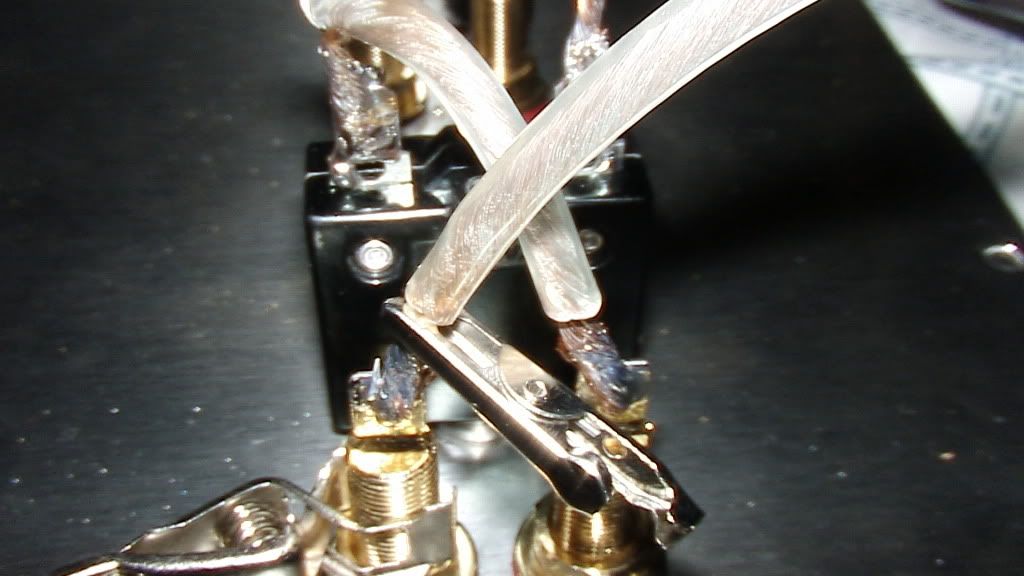

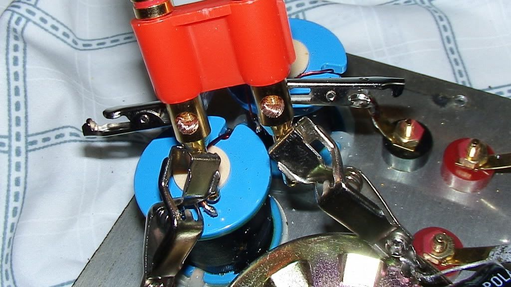

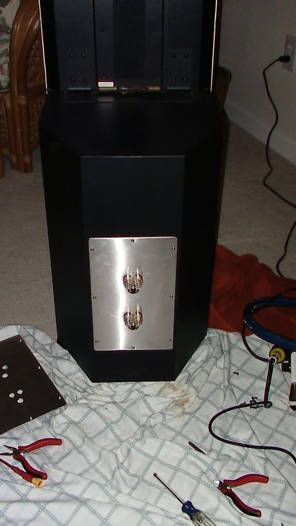

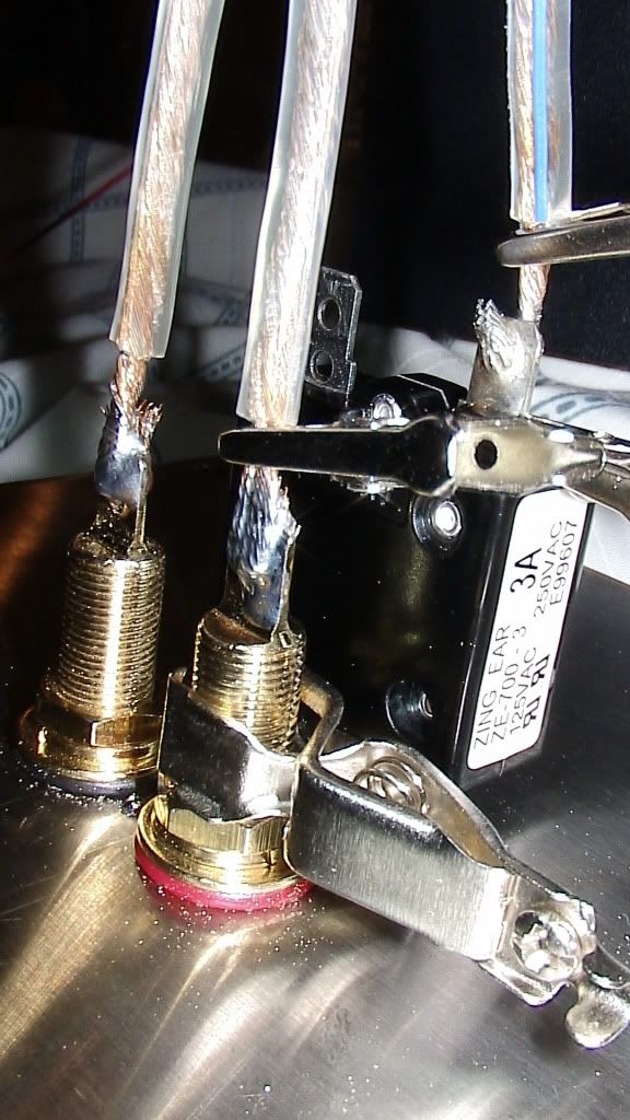

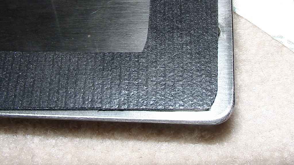

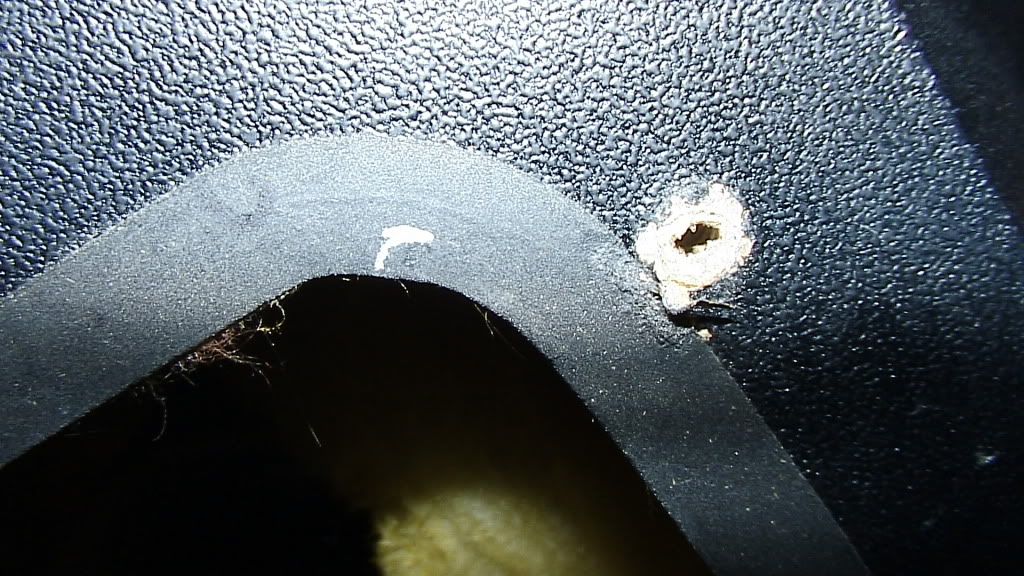

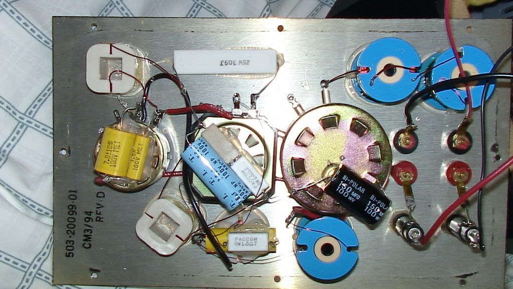

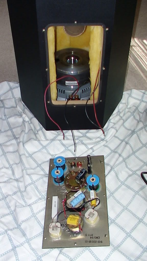

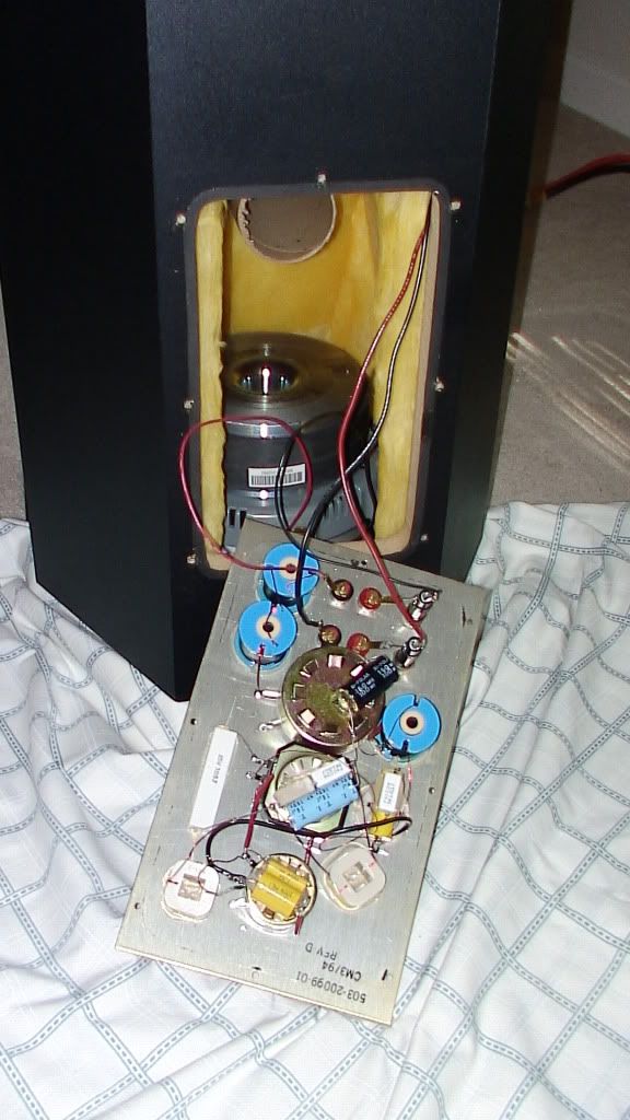

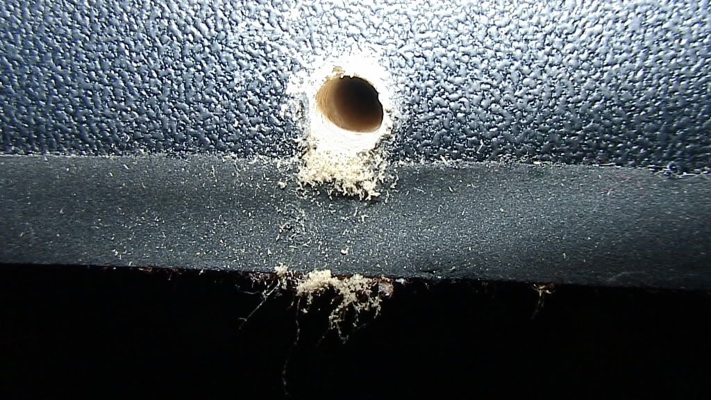

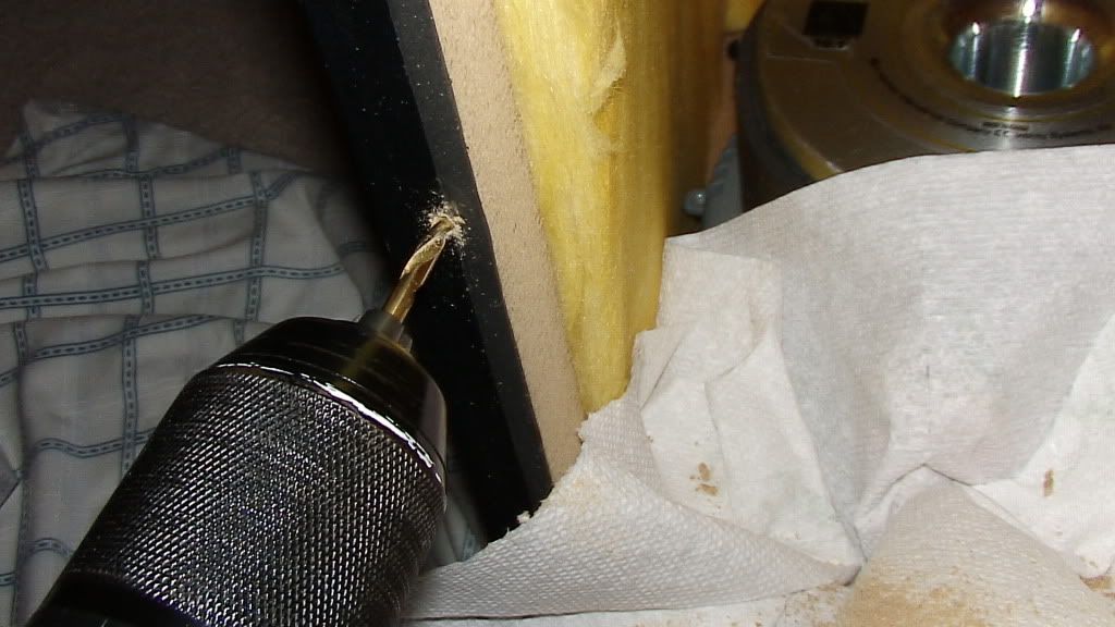

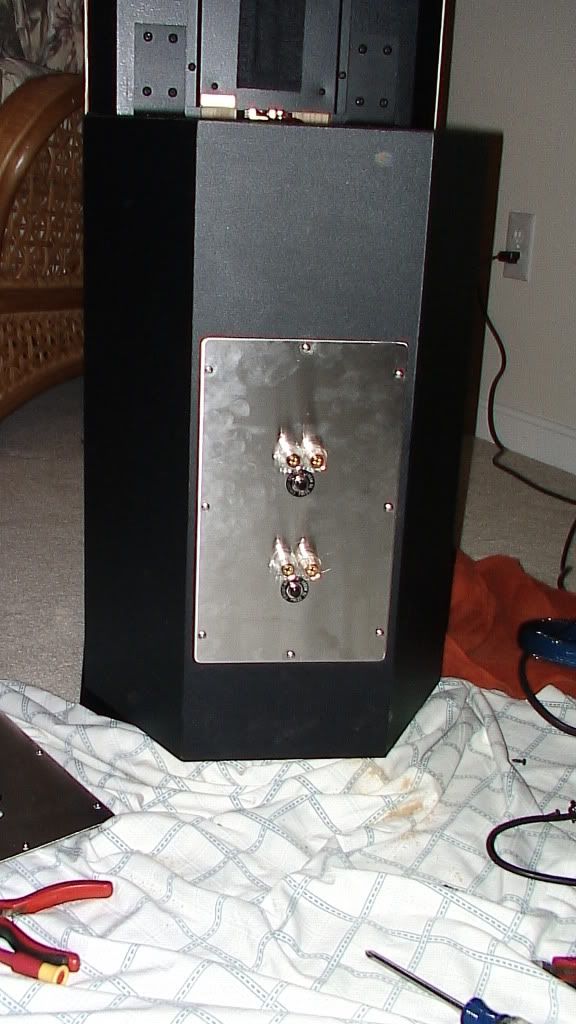

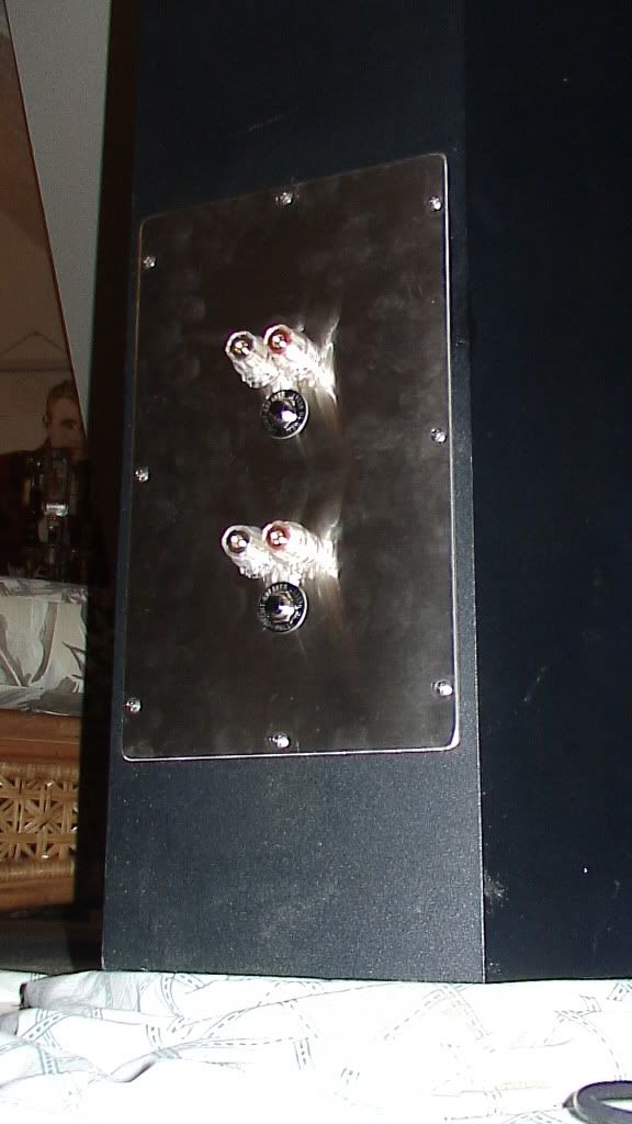

Got one speaker done tonight; what a FREAKIN' ordeal! I learned a couple of things, not the least of which is to drill out the mounting holes & install the blind nuts FIRST~ the side nuts required some modification in the form of bending as they sit right at the edge of the 45 degree angle that goes from back to side/back on the AL-IIIs...
Started off looking like this:
And the end result looks like this (pardon the fingerprints):
But FIRST, you have to start HERE--original hole:
Drilled new holes to match the 6/32 stainless steel tapered-head bolts (1 inch)

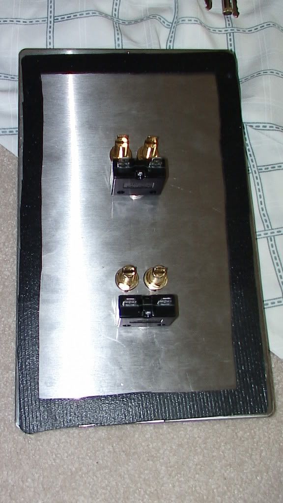

Sized & cut some thin foam seal (originally made for lining a truck tool box) to prevent air leaks/farting around the panel:

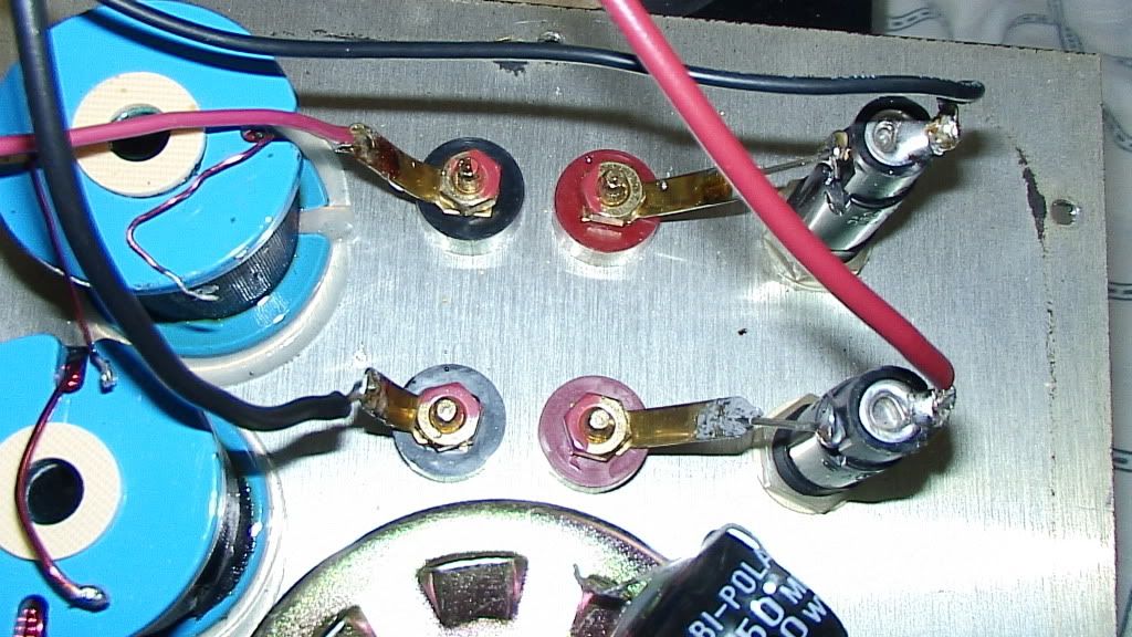

Began de-soldering the wiring to the crossover & speakers:

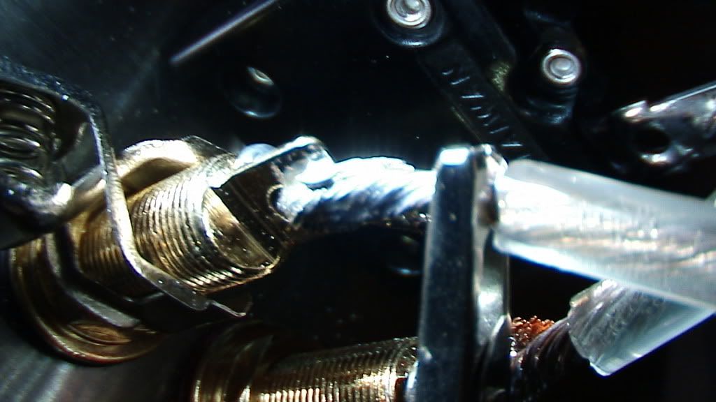

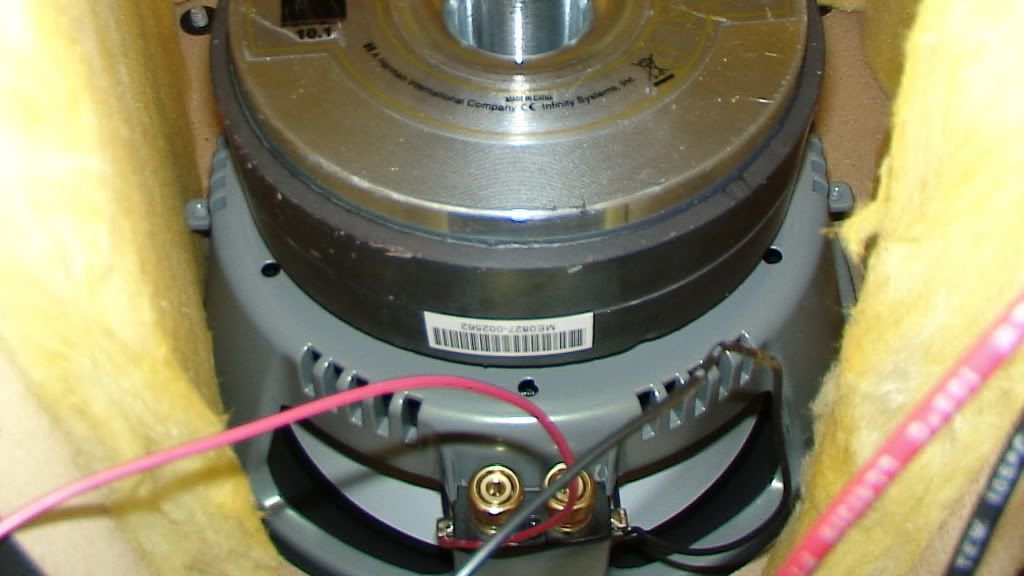

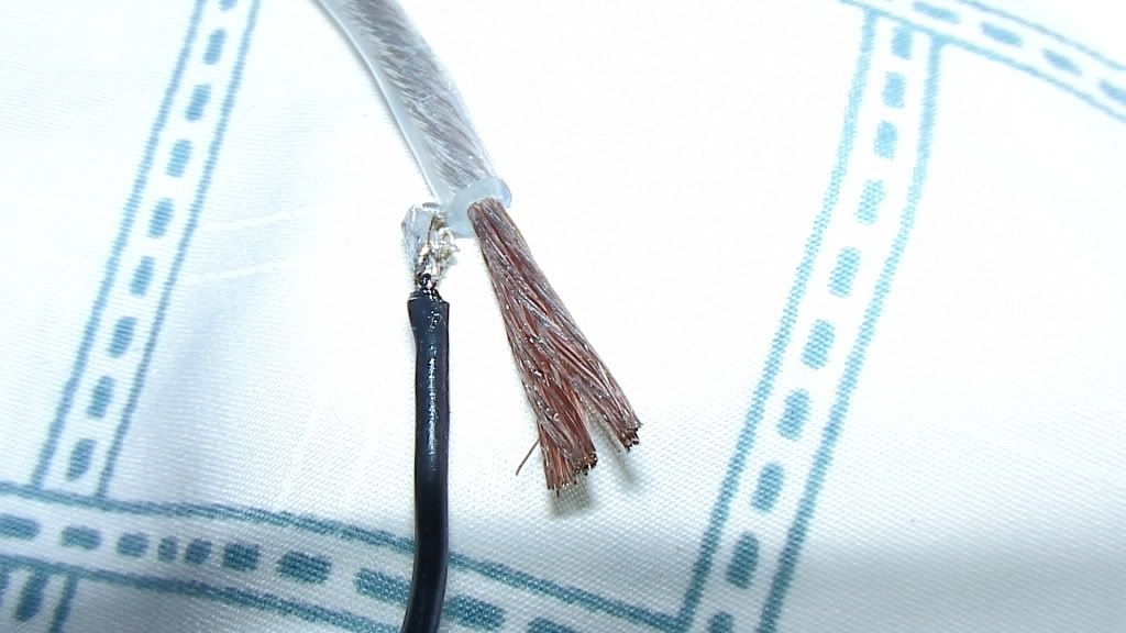

Went up to 12 gauge monoprice oxygen-free copper wiring from the original, wimpy (& NOT copper!) wiring:

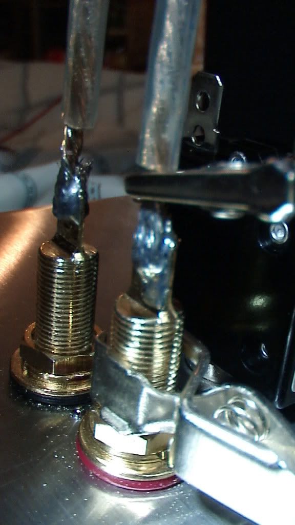

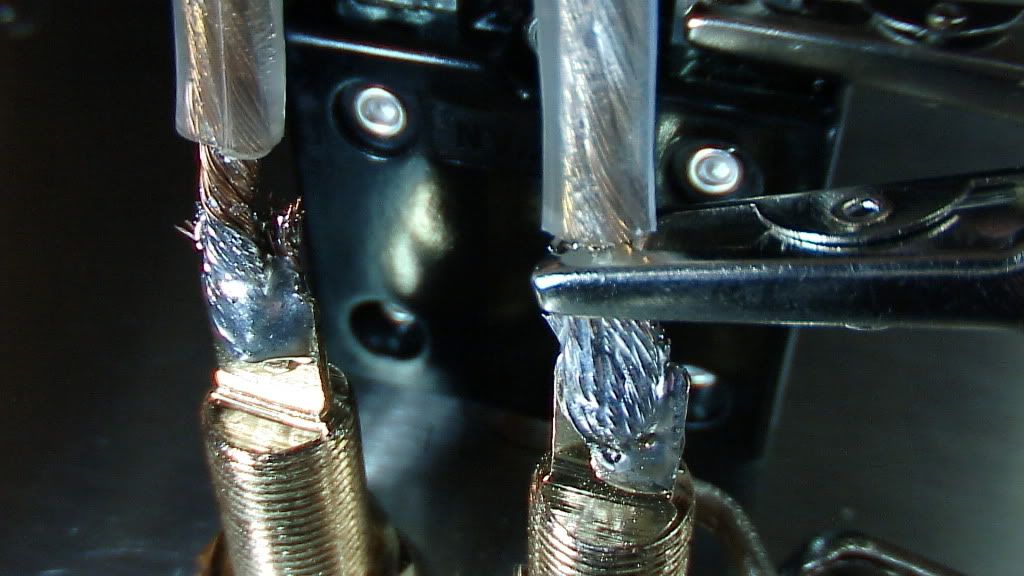

Heat sinks in place (made a HUGE difference in heat transferred to the wire insulation & binding post plastic parts:
^^^ I ended up soldering banana plugs to use with the woofer inside the cabinet as it was too difficult to try to solder in there. The monoprice bananas worked out GREAT & fit right into the woofer connectors (3/4 " on center).
I had to drill out the holes in the binding posts to get the 12 gauge wire through them:
UGLY solder joints w/heat sinks in place:

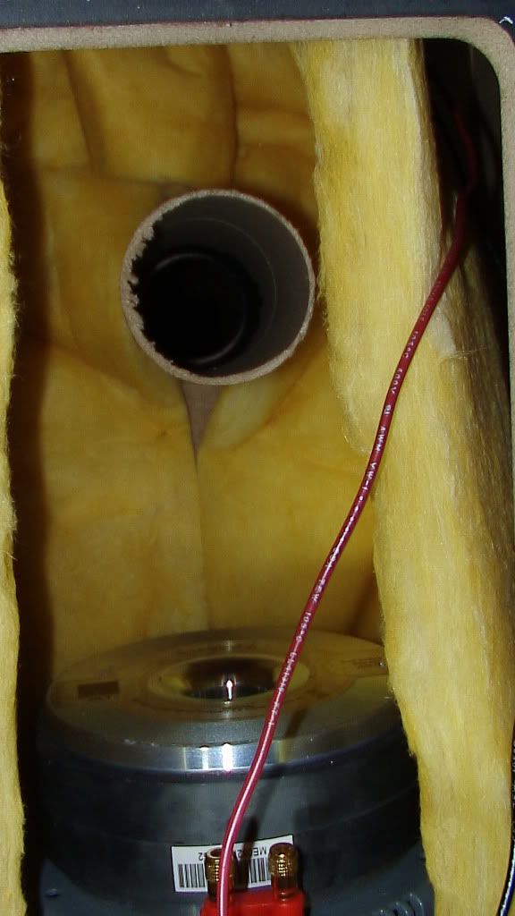

A shot of the port tube:
It works! Couldn't crank it tonight as it was too late, but will do so tomorrow afternoon~
\:D/ \:D/ \:D/ \:D/ \:D/ \:D/ \:D/ \:D/
