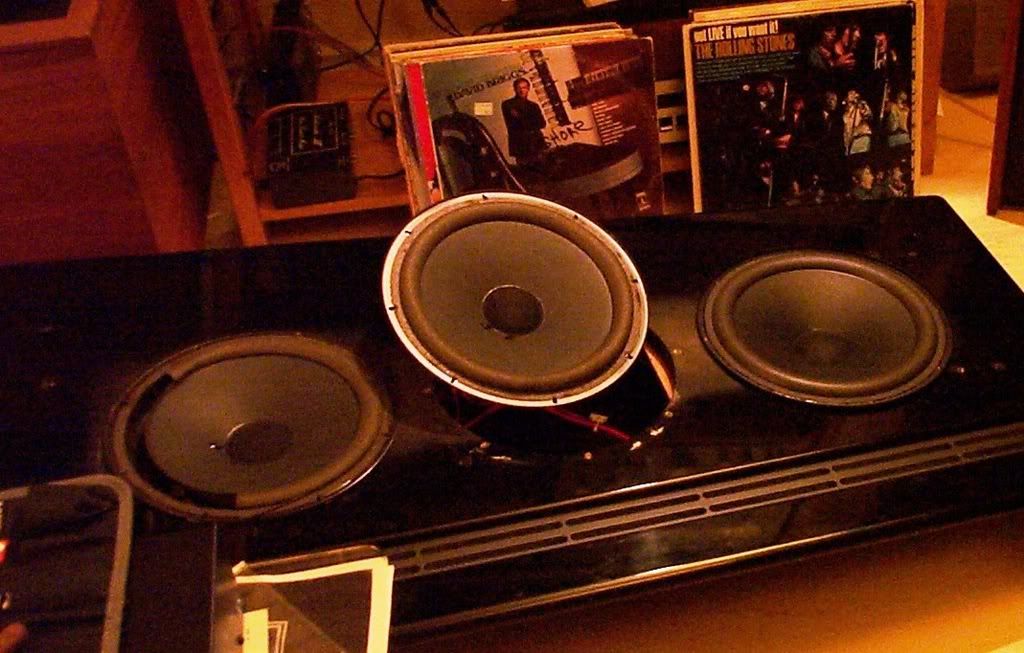

Ok will try to post a couple of pictures as I swap in the new woofers. Here's a cellphone camera shot from the other night when I unscrewed the old woofers. The x-overs are huge, everything looks clean and new (I'm used to looking at much old speakers).

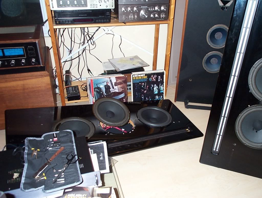

Yep, being lazy because it's a quick shoot and email to photobucket operation with the mobile phone. Ok, here's a couple real pictures....
The drivers are all in sequence on the same speaker wire (two red, two black leads) from the x-over, but it's interesting that each is connected differently.
The 1st driver (top, closest to the x-over) is connected with a single red and black on the + side and a single red and black on the - side.
The 2nd driver (middle) is connected with both red wires on the + side and both black wires on the - side.
The 3rd driver (bottom) is connected with a red and black lead on the + side and just a single black lead on the - side. I verified the drivers are connected like this on both speakers.

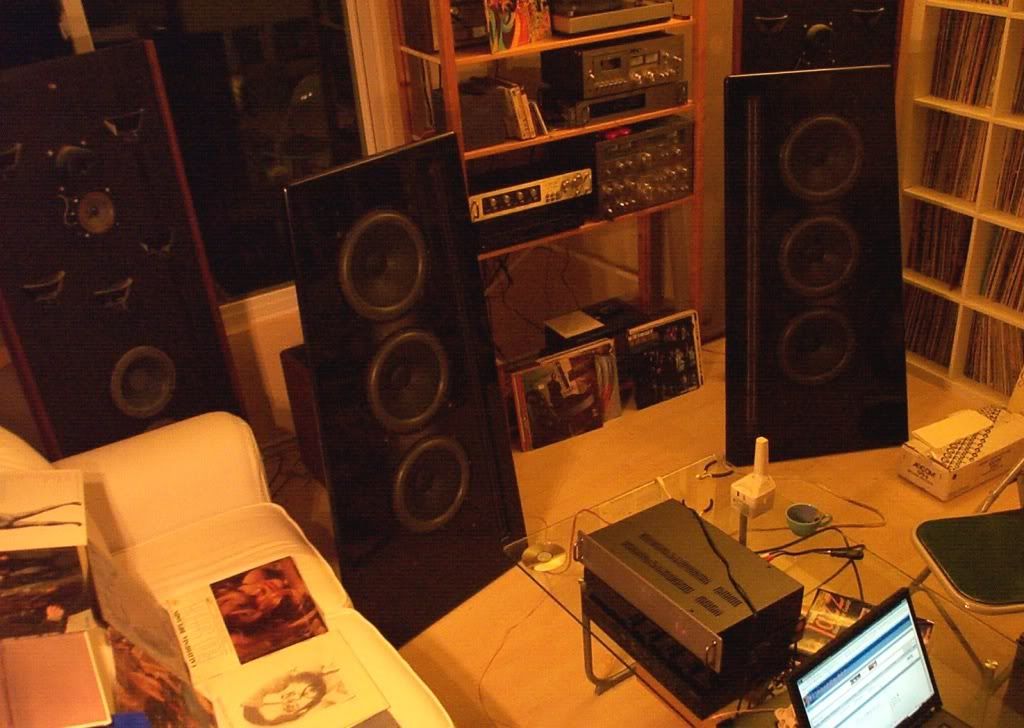

The new woofers are in-place and wired correctly, and I have been doing some listening today in the (crowded) living room. The surrounds are getting a workout.
Listening to the Amazing silvers right now driven with a Carver M-1.5t and Nakamichi CA-5 control amp + ST7 tuner -- KPLU-FM "all blues" programming. Have also been listening to some jazz CDs. The speakers will go into a small downstairs room soon where I can work on placement.
These silvers can take all the 350 WPC amp can give and want more. I have a PM-1.5 amp I'm not using, so I am thinking about a configuration that uses both amps. The M-1.5t gets VERY hot.
