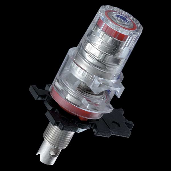

Not sure if any of these are any better... I have never seen any of them in person, but for the price, it's worth a shot...
http://www.partsexpress.com/webpage.cfm ... D=417&SO=2
Besides, if you find a pot you like you can always change out the posts with these...
http://www.partsexpress.com/webpage.cfm ... D=107&SO=2
I like these....
http://www.wbtusa.com/
I like these....
