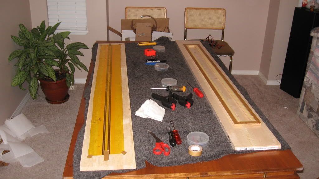

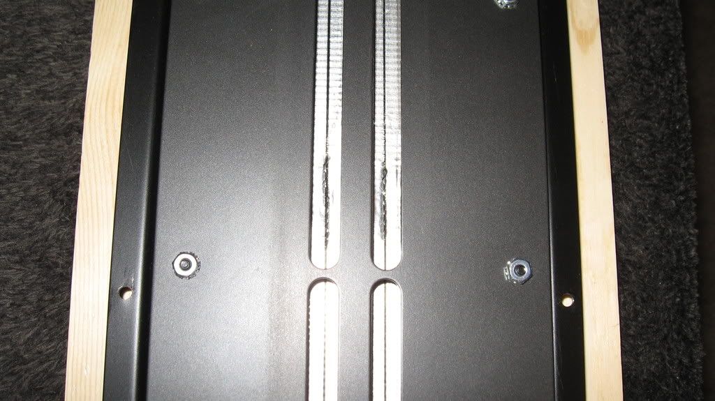

we have successfully replaced the kapton in the center speaker (a 48" ribbon spare we had)
Here's some pics of before during and after....
The ugly rips that a brat did
laying things out...you can't see him but Dave is on the speaker phone talking us through this \:D/
Gerhard putting it back together...uh we only lost one wood clamp....boy those magnets are powerful it flew accross the table Dave heard it and said... `that didn`t sound good` teehee ....only a clamp not a magnet thank goodness!
TaDa....it works holy chit!!!! not nearly as pretty as a repair by Dave but it works.... THANKS DAVE
