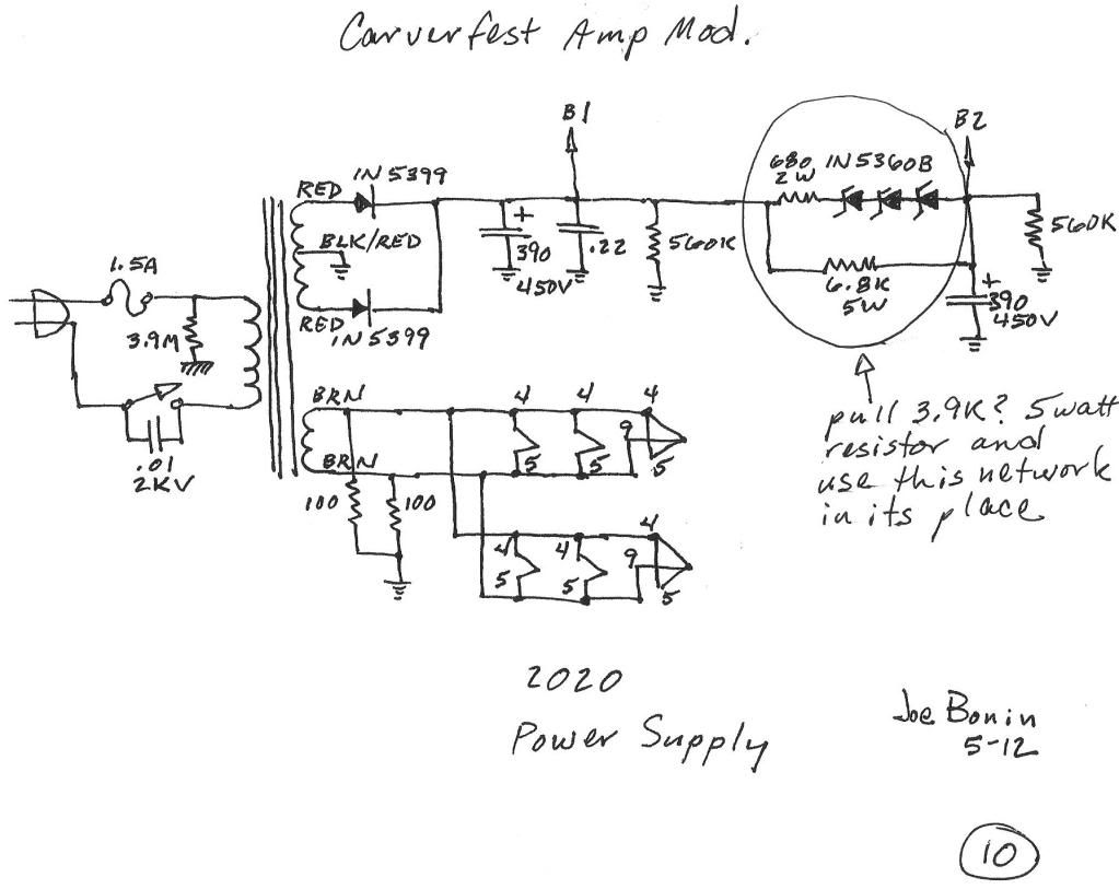

so, the update from joe has arrived on the power issue.

My times 2 WTF quote from Gary: I was referring to the schematic Angelo posted. My bad, I should have clarified.

hhhmmmm,......
so the extra parts in the pic of the 2020 amp power supply makes more sense now.....
the extra caps and resistors.
cool...... =D> =D> =D>

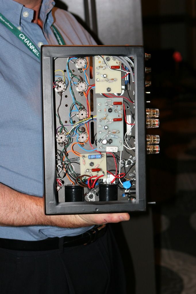

I cant find the pics I saw of the inside of the proto 2020, any body see these?
