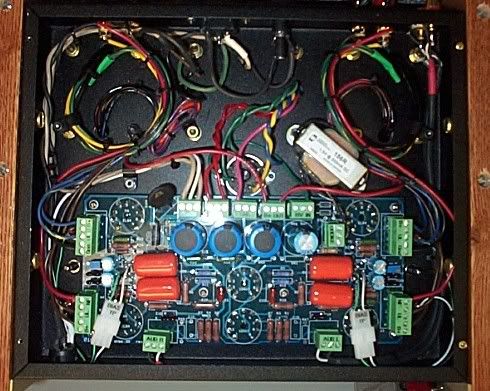

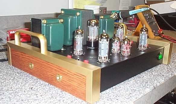

As a real fair check, I decided to pull out another EL84 amp I built a few years ago. It's based on the Dynaco ST-35 design, the baby brother to the ST-70. It uses a 12AX7 input, 12AU7 phase splitter and then the same EL84 push pull output. On my build, I decided to go with a tube rectifier, which is probably the biggest difference from the CF amp.
You guys that have just built (or are building) will notice right away that the circuit board construction makes building different than point to point. I did this one with the green Euro blocks so that I can completely unplug and remove the PCB in just a minute if I wanted to. This design is fixed bias, which means once in a while you have to meter and reset a voltage for each output tube. I made this simple with test jacks on the top (3 little pin sockets down each side) and access there too to tweek the pots.
Anyway back to the audio amp comparing...I paused the playback and plugged in the Dynaclone, let the tubes come up and went back to play. Immediately a small but noticable difference was there. Just a touch smoother, even before warm up, and a tad more depth. No frequency changes or gain difference. Just a little more music.
I'd lay this at the feet of the power supply. There are other small differences but this is something I've spent a lot of time at. I actually have 4 of these Dynaclones in various configurations. Much of which is power supply. And you can hear this smoothness of a tube power supply over SS diodes represented among them. So this probably belongs over in the mods column, but some small but subtle changes on the power supply might be considered. If others also have slightly high B+ like I do, then there is room to consider adding a second stage of filtering. But probably more important and not much cost and no space really, would be change that pair of rectifier diodes. Some HexFred diodes might do a subtle but nice improvement on imaging in this. Something that may be able to be explored at some future time.
