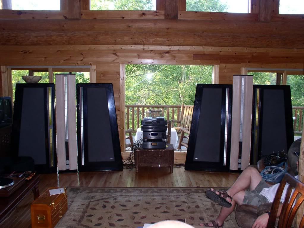

That would be MY 400x7--that happened at CarverFest '07. We ran it EXTREMELY CRAZY loud with no shut down, noticeable distortion, or excessive heat.
Realize that the average electrical voltage there is 128 volts, so you've got some extra oomph there that you wouldn't normally find.
EDIT: A conservative calculation gives that an approximate 1.4 Ω load.

Wayne, it was exactly as stated. 3 pair of Amazings: Platinums, AL-IIIs, and Originals--all with passive crossovers in place & all tied into the L/R MAIN outputs on the amp. All driven off the 2 main channels directly, in parallel. Like I said, @ 1.4 ohm load.
