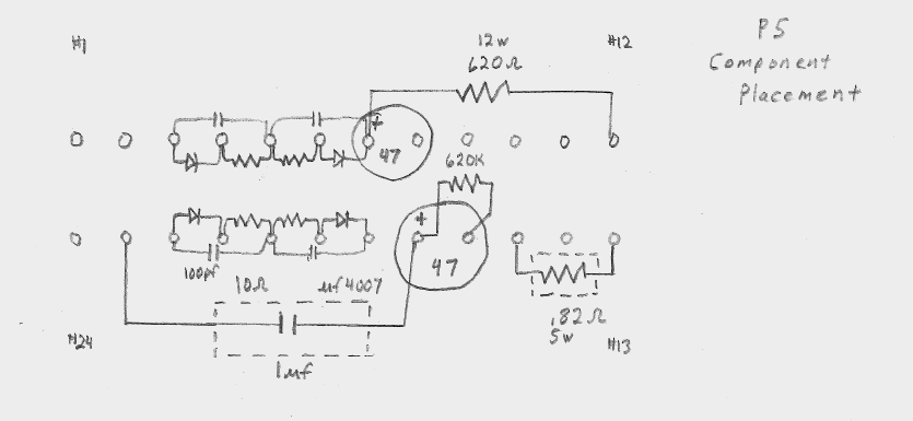

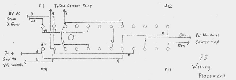

Here is a drawing for where the wires go on the Power Supply PCB...
Then here is where the components go on at....
You will notice on the PCB when you start, two things. One...is the hole through the middle. This needs to be paid attention to which end it goes as om the top drawing. Two...the small black and red wires crossing directly across the board, I have drawn lines on in those colors to help you get started and orient the board the right direction.
Pay attention to the wire colors. All the little wires are provided for you in a little bag. Lay them out by color and size and you should have all the colors and lengths needed on the board.
The wires coming from the transformer, the filament center tap wires and the HV AC from the transformer get added later when both the transformer is mounted on the chassis and this Power Supply module is attached. So don't worry about those yet. Transformer wire colors are noted on the main overall schematic in your paperwork.
Also note in the drawings the numbers off to the side. These numbers, 1 thru 24 help tell you the post number. Count left to right across the top and then back again across the bottom.

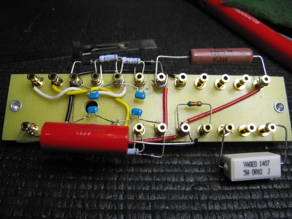

Post by radioeng2 » Tue Sep 16, 2014 8:09 am
To go with the above drawings of the Power Supply PCB....here is a photo of a board with the wire jumpers and components except the big caps...
And then after adding the pair of big caps on....
If you want prettier, then you can probably check Mike's or later Martin's.
The idea is to keep the big resistors in particular away from the board and especially the caps.

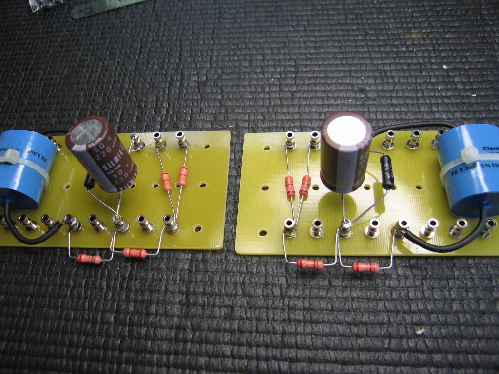

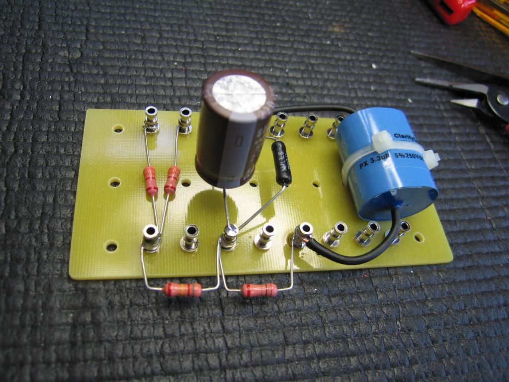

So the next step is probably to put together the Linestage PCB's. Few components, easier as long as the posts take solder ok.
Again, a bigger resistor there, we want it out from under the cap for heat and longevity purposes.
So don't forget....the pair of these PCB's need to be mirror image!
The 9 pin tube socket little jumper wires will come up to these boards. The audio goes in and out on the bottom side along with a few other connections. The PCB's mount between the long 4-40 screws that come down through the tube socket. One end of the board goes on the octal and the other end attaches at the 9 pin. We screw a nut down on those long screws with a washer, drop the board down and then bring a nut down on top leaving clearance to see the tube sockets and be able to do any future necessary work.
One of the goals in particular is to have short leads on the grid over to the pair of 3.3K resistors. And to keep the grid leads away from filament wires too. So orderly and clean as possible on the leads is a good thing. The drawing in the paperwork is a good guide for those wires coming over to these PCB's.

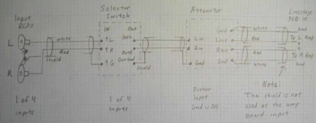

The audio wire in the kit is Mogami. It's a real nice 2 wire with shield. It is a soft jacket and needs care to cut without also cutting the strands of the shield or more.
We can use the 3 conductors in more than one way. In the case of the Linestage, I'd suggest wiring the input jacks with the Red as Right, White as Left and the shield as the audio ground. That's from the rear input jacks, to the selector switch. Same then from the selector to the volume attenuator.
But from the attenuator output over to the Linestage cards, it makes more sense to switch to independent runs of cable and use the Red as the hot, the White as the ground and the shield as a shield. So here is what that looks like....
The input switch has a key feature of switching not just the audio, but also the audio wire ground. This allows the Linestage to not internally have connection to all your input components at all times. Only the device you are listening to has it's ground "shared" with the Linestage.
To implement this feature, we need only to use care that the rear input jacks have the shouldered washer keeping the body away from the chassis. And that at the switch itself, we keep the shield wire away from each other. So twist the shield, slip jacket or heatshrink back over it and keep the otherwise bare shield wires from each of the four inputs from touching each other. A little care here has some nice benefit!

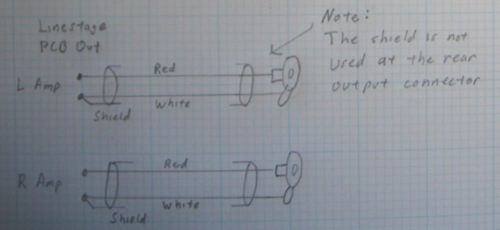

Then the last step on audio wiring is to route the Linestage output out to the rear output jacks. The same technique of shielding can be used on them. Independent wire for left and right.
So the way shielding works, the shield should be used at the lower impedance end and left open at the other. That way, any noise is drained to the ground at the end less likely to "receive" or pick it up via crosstalk. So at the output end of the wire, the shield is grounded. And at the end it's an input, the shield is cut off and not used.
