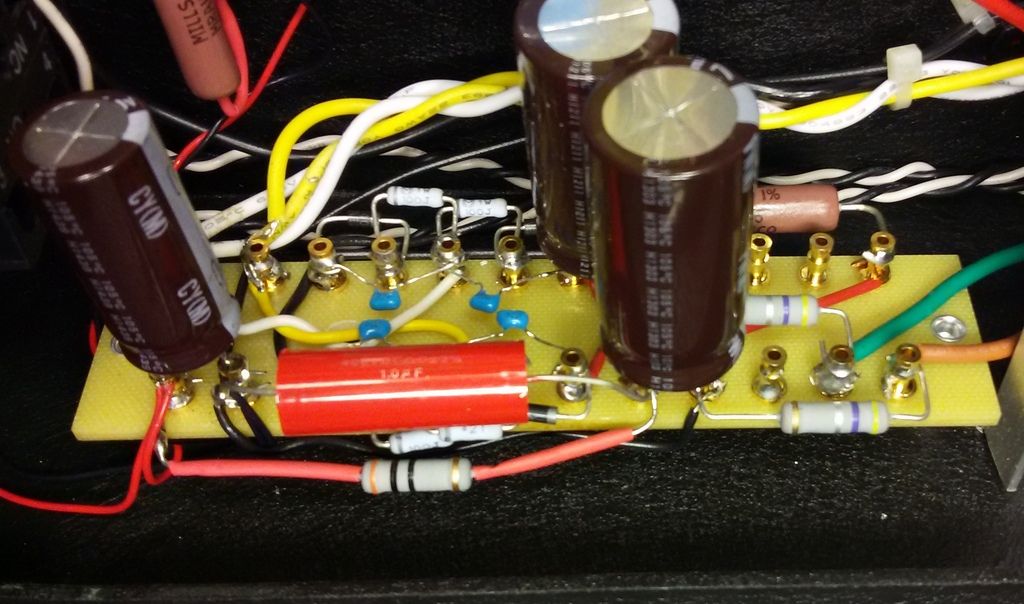

This picture shows the two resistors in the filament supply to the right. Then towards the other side, the added resistor with red heat shrink down low going towards the left end where the added cap is.

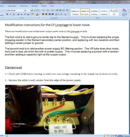

I've put together a bag with each persons name that bought a LS kit. It has in it, line by line specific info and pictures showing you in detail these two mods.
It also has a new full schematic showing the additions. Then, there is two small plastic bags with the parts. The first, is the two resistors for the filament center tap addition. Second bag is for the PS additional filtering and has the resistor with heat shrink and the cap. Also, three people were gone last year before we had the CF LS14 badges on hand, and those three also have those in their mod kit bag. Thanks again to Eric for those!
Tools you need...fine needle nose pliers. Very important. Some small dikes to trim ends. And a soldering iron. Should be less than 30 minutes for most to do...an hour for Al and 10 for me to fix it. :lol:

These are right there at the edge of the supply like the picture shows. Needle nose are the key...really is. Nobody has small enough fingers to do anything in and around those areas. And were talking the tweezer end kinda ones too Ray...not some plumbers ones! :rolleyes:
