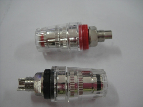

Every speaker includes a single pair of binding posts. However, I we are NOT drilling the large 3/8" holes in the back of the speakers. We will "mark" where the holes need to be drilled if you want to mount the binding posts to the speakers themselves.
The reasoning behind this is, not knowing how many people would or would not be using our stands, which are designed to work in conjunction with the speakers themselves, using an interlocking mini XLR connector, we did not want to have 2 large 3/8" holes in the back of the speakers that would need to be sealed air tight if the stands are being used. The stands will also have the binding post locations marked. Everyone can choose where they will put their binding posts themselves. I know it may not seem like much at $7 a set... But when you add up the cost... 4 sets for 60 sets of speakers.... that little $7 set of parts becomes a $1,700 bill worth of parts that may or may not even be used. In trying to keep the speaker kit and stand prices under control, these kinds of decisions had to be made. Same exact thing with the spikes... We opted to tap the holes, so you can choose... if, and which spikes you would be using.
For everyone going to CarverFest, we will be bringing our mini drill press, and cordless drills with us, you will be able to drill them yourself, or ask someone to help you.
We only purchased enough binding posts to cover the quantities of speaker sets sold. We figured everyone would use one or the other. You really can't use both at the same time anyway.
If anyone should want (2) sets of binding posts, one for the speakers, and a 2nd set for the stands, here is the link to order yourself a 2nd set.
These are the same binding posts I have been using for years. They are the same ones I used on the 8' tall ALS Bob and I are building.
I have been buying from this supplier for about 5 years. Very good quality and fast shipping. Highly recommended.
http://www.ebay.com/itm/1-Pair-Speaker- ... 27bf55ba88

Al - the posts are standard 5-way. Bananas OK.
RR
