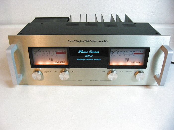

Sometimes you get lucky and all they need is a few joints resoldered, a couple bulbs, some deoxite and an extensive cleaning.

Then you just enjoy it for another decade or two.

That's one hell of a restoration job you got there. She looks to be cherry now. Nice job.

Krylon semi-flat black is the perfect match for the chassis. Its just getting harder and harder to find.

The PL700B has a slight 120Hz buzzing in the speakers when the pots are turned midway.
You can eliminate that by sanding a spot around a bolt hole and grounding the anodized
aluminum faceplate to the chasis.
