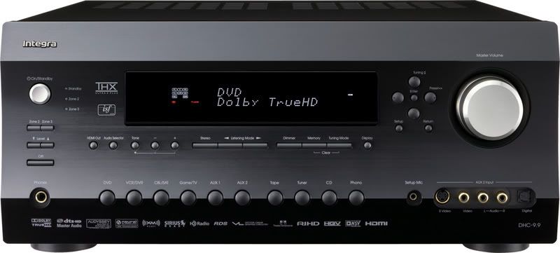

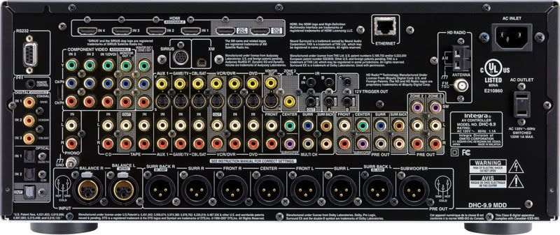

Post by Mr. M-500t » Tue Apr 07, 2009 7:33 pm
Here's what I just bought for my 6.1 system. Plenty of crossover settings and bass management. I like it so far with my 3-M-500t's.
The Audyssey microphoned speaker calibration and Audyssey EQ is really cool.
These are of the 9.9 I bought the 9.8 new for far less.
Here's a review from AVR.
http://www.avrev.com/home-theater-pream ... essor.html
