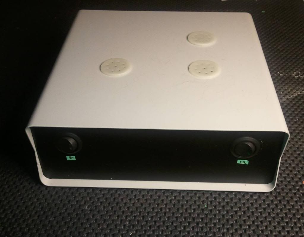

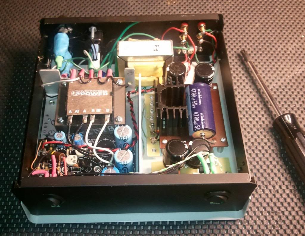

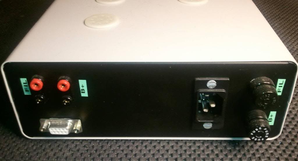

Here is an example of using that $50 adjustable PS brick in a power supply for a preamp.
Front with seperate Filament and B+ switching
Rear side with IEC, fusing, PS output connector and metering test points
Interior with adjustable HV B+ supply and regulated DC filament side
DC filaments is a level that isn't absolutely required and as you can see adds complexity and space requirement. Something to consider carefully is when adding things for higher quality or taking on not absolutely required features, is that it can really add to the effort you have to go to. Drilling mounting screw holes, wiring things in, buying materials. Figuring out mounting and spacing. And so on....
